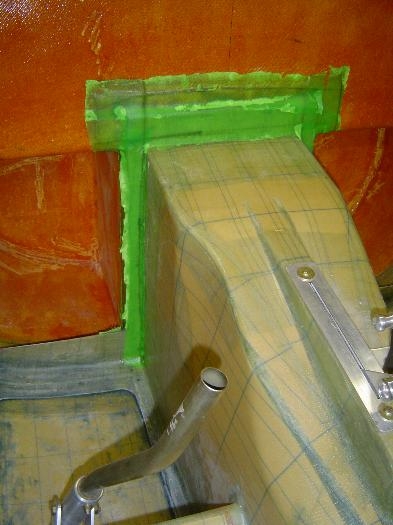

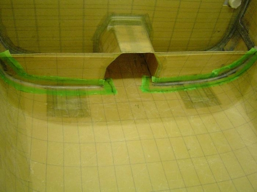

Brief Description:  Reinforcing of the Bulkhead and Baggage
After The CM has set. I preceded with the reinforcing of the bulkhead and baggage bay, Simple layups of 3 ply’s of bid around in to the flanges. With an application of Flox to fill any holes.
