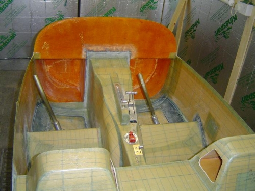

Fixing the CM into the fuselage is a really big moment and very difficult on you own, but I did it. Redux/Flox is applied to all the contact areas. Then the CM is lowered into the Fuselage. I relocated all the fixing points with small bolts and rivets to hold it in the correct position. I did have a problem with voids under the meeting surfaces, so I drilled small hole in the top and injected Redux to fill them. The finish is not as neat as I would of liked But Job Dun!!!
I will remove the small bolts and drill out the rivets after it as cured.

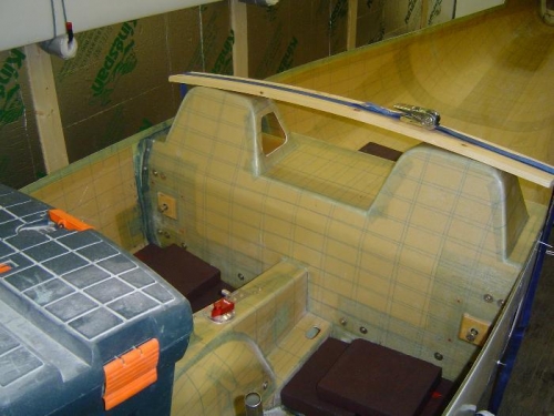

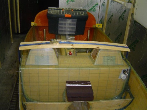

Strapped Down
Strapped Down
Tool box for extra Weight
