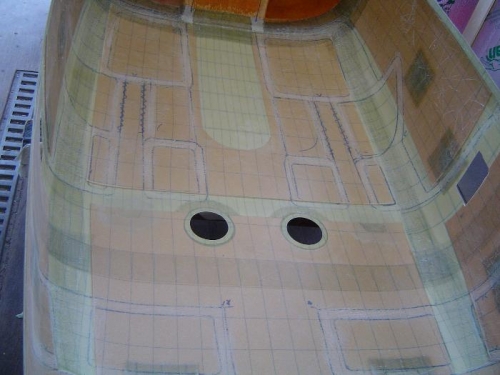

Prepared For Bonding
Finally go to work on the CM and get it ready for bonding into the fuselage. All contact areas are scuff sanded which are in contact with each other. I drew around the CM to get the correct position.
