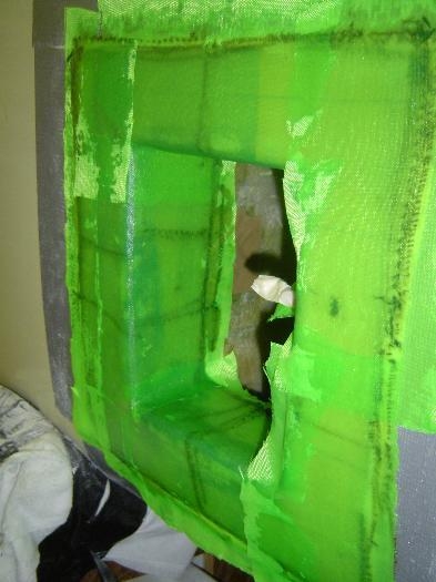

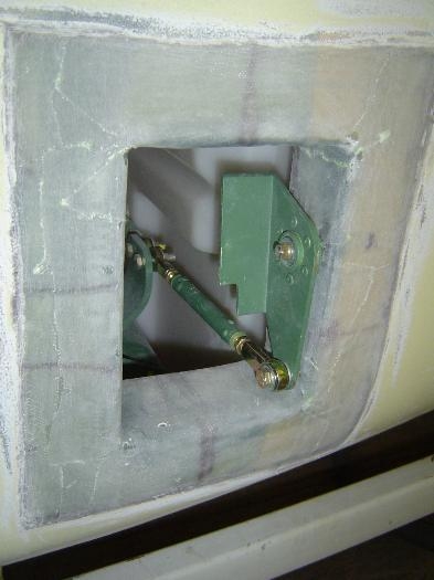

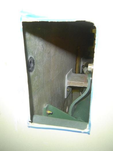

Cut the holes
Cut the holes in the side of the Fuselage for the wing Spars. These are trimmed back to the brackets, and a layup of 3 ply’s of bid are arranged around and onto the fuselage from the brackets, This has made the brackets very strong.
Cut the holes
Layup
Finished
