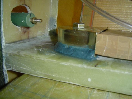

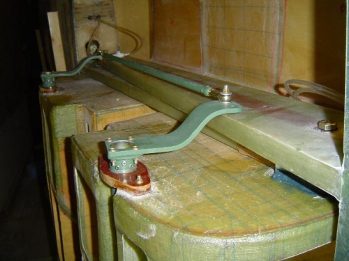

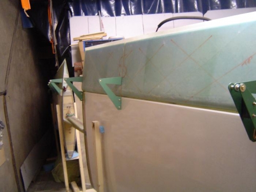

Started by making some wood wing supports to hold the wing in position for setting up of the spar sockets. The wings and the CM have to be set vertical for this set-up. Spar sockets are bonded one to the STBD side of the CM and the other to the Port wing spar.
The reason for this set-up is to get everything in line with each other. The spar sockets are bonded with Redux/Flox and the bushes in the CM all together. The job is quite easy but the time setting everything up takes longer. Everything is held in place with two bolts until the Redux has set. I only just got the wings together in the workshop.
Test fit, only just enough room
Port Spar Socket
Port Spar Socket
Left to set
Left to set
