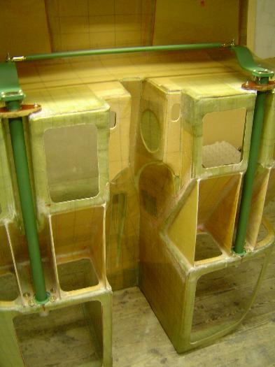

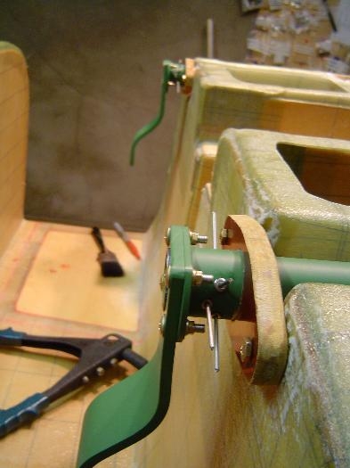

Continued on the controls. I made some pushrods and panted them with Zinc chromate. Further work on the torque tube rear tufnol bearing. This is made to shape and fixed with bolts and a flox pad to get everything straight with no binding or stiffness in the movement. Once I was happily with the movement it is all riveted together with Redux. Look nice.
Some Pushrods
Some Pushrods
Ready For Fixing
Ready For Fixing
All Fixed
All Fixed
