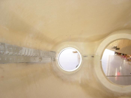

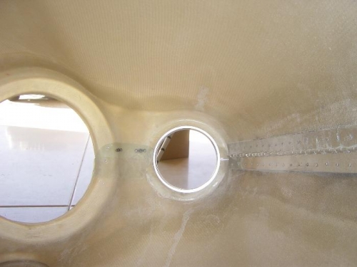

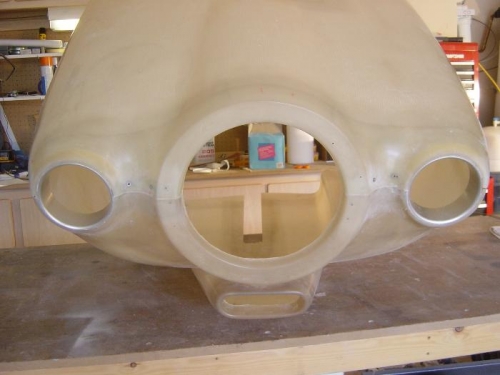

Not much anbition today, Spent msot of the time, seperating the two cowl halves. I was worried I would have problems as I only put the clay plugs/dams in at the last minute yesterday, So late last night after the Flox had set up semi firm, I turned the cowl upside down on the table and then crawled up inside to see if I was going to has any problems. It's a good thing I did because there were severareas where they last minute plug didn't work and I had Flox which had flowed so as to make a countinuous ring (not good for seoerating the halves) forthnatly the flox was still plastic enough to allow for me to gouge out wha t I hopes would be some clear seperation gaps on each side of each ring. In the morning, I set out to see if they would come apart. Will James had said to use a mallet arounf the ring openings to help and seperate them from the flox, so I gat several healthy taps around the perimeter of each ring, then pulled the hinge pins and began the process of carefully seperating the halves, and to my amazement after 20-30 minutes of cautios encouraging they split! It took another hour and a half cleaning out the modeling clay and sanding/grinding the seperation gaps so they are somewhat smooth and cleanig up the rings. I got the side (horizontal seams/gaps sanded to the right dimension, there are serveral places that need filling, so that will be the primary task for tomorrow. I should have all edges and gaps adjusted by end of week. Next week, I'll sand, fill pinholes and prime it. Also do the oil door.
All cleaned up with the rings floxed in place
inside shot of the right intake ring
Ditto for the Left
