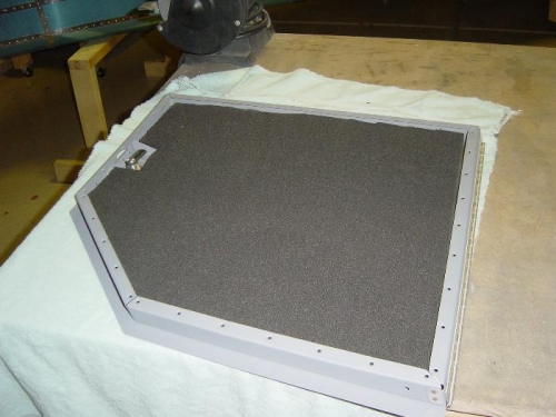

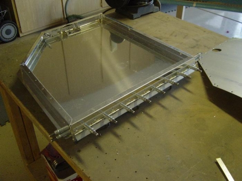

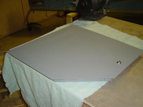

The door locks, and ignition switch/key's arrived today, so back to finish up the Bagage door. Deburr all the holes and edges, Prime all parts. Cut the hinge and match drilled, deburred, and countersink, then rivet to the fwd brace. Then rivet the braces to the outside skin and to each other. I 'back riveted them, but instead of using the back rivet set (not enough room) I used the long handled bucking bar, that has a pretty long foot on one end, That and a 2 1/2 lb sledge, and 3 whacks later = a set rivet. Took a little longer, but it's the only way I could figure to get it all riveted. Worked out fine, there were two rivets that were a little high, dressed them with the Vixen file and on we go. Installed soundproofing, installed the lock and then pop riveted that inside skin. Started on the attach to the fuse, but it's too hot, that will have to wait til Monday. Tomorrow & sun I'm going to the Nuckols wiring seminar in Prescott
Assembly clecoed w/ hinge
Primed,riveted and soundproofed
Finished product w/ Lock
