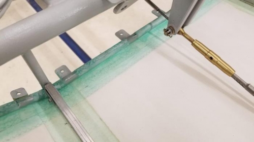

Brief Description:  Additional Belly Former Fabric Tape
I had Jim Harden come over to the shop and give the fabric a once-over before painting. He identified a few areas that needed attention. I had put on a tape for the front belly former, but I just put the front edge on the former and didn’t wrap it around. He said it needed to wrap around and join the backside so it’s a strong seam. So, I took a piece of 3in tape and went from the belly fabric, wrapped it around so it was also glued on the backside. It’s not coming off now!
