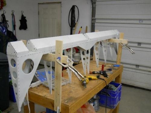

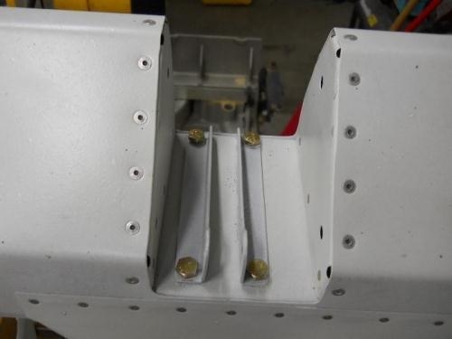

"I took the flap off again and made the adjustments then put it back together. It lined up a lot better so I marked the hinge attach angles for attachment to the flap spar. The hinge is not centered in the opening but favors one side to allow a bolt to fit into between the side and the hinge and slide into the opening. I was working on mounting the hinge attachments when I got a call from Jared. He was in town and wondering if I happen to be working on the Bearhawk. I ran into town and picked him up. It was great to have Jared over and we had a nice visit. I finished mounting the attach angles to the flap spar and Jared helped me fit the flap onto the wing. The middle hinge was a bit difficult but we were able to get it lined up. The flap move with no binding noted.

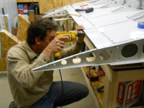

Next I started on the aileron. The hinge lines up best with the premarked dill points as published on the plans and as I marked them when I layed out the spar caps. I drilled out the top hole then bolted on the hinge to drill the bottom hole. I have the drill bit that Eric shows in his manual to drill the aileron hinge but I still haven't brazed it yet to the tubing to lengthen it. I went to use the gas torch and my acetylene tank was empty. Jared and I jumped in the car to run down to the welding supply store but they were closed when we got there."
Setting Flap Hinge Attach Angles
Hinge Attach Angles Mounted (Note Offset Mount to Accommodate Bolt Insertion)
Jared Snapped a Picture - Me Drilling For Aileron Hinge
