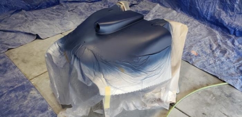

Primed and applied basecoat to ailerons, lower cowling and front deck
7/2 4
-Taped off lower cowl and added blue basecoat
-Clear coated ailerons, lower cowl and front deck
-Primed upper cowl
-Messed up first coat of base due to forgetting to spray out residual lacquer thinner. Will fix tomorrow. Third times a charm.

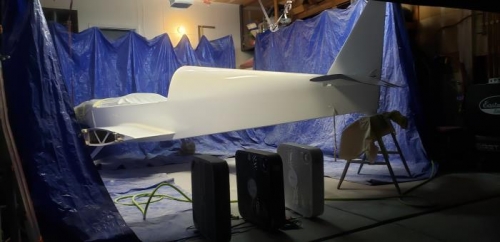

Prepped/painted rudder and tail fairing

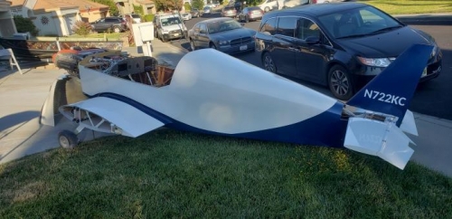

7/30 3
Primed fuselage
7/31 6
Painted fuselage
