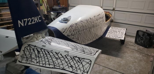

Brief Description:  Paint correction
8/2 1
Cut and buffed rudder
8/3 2
Finished rudder buffing
Started sanding fuselage w/1000
8/4 1
More wet sanding
8/5 1
More of the same
8/9 1.5
Same
8/11 3
Same
8/12 3
Same
8/13 1.5

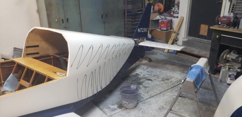

More clearcoat sanding w/1000
8/18 6
Finished with 1000 grit
60% done with 1500 grit
8/22 3
Finished 1500
25% done w/2000
8/23 6
Finished 2000

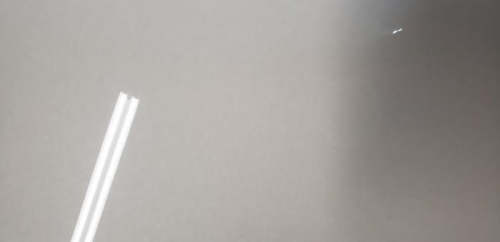

30% done with 3000
8/24 6
Finished 3000 grit
Started buffing
8/25 3
Finished step 1 of buffing
8/27 3
Finished step 2/3 of buffing
Installed rudder
Sanded top cowling to 2000
8/28 4
Finished top cowling
Finished lower cowling paint repair
Installed speedbrake
Installed OAT sensor
