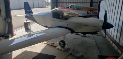

Brief Description:  final assembly/weight and balance
8/31 2
Painted spinner and trim tab
Finished seat clearancing
9/1 2.5
Wiring and hardware finish work
9/2 2
Pilot test c/w 3 knots lost in one min
Sanded and buffed spinner
Found CHT#1 issue
9/3 3
Sanded and buffed canopy frame
9/4 2
Worked on scratch removal on canopy
Installed new Regulator and test ran engine
9/28 1
Fixed CHT 1 wiring
Ran new power wire to EMS
9/29 2
Wirind cleanup
Canopy scratch removal
Installed new air inlet duct
9/30 2
Finished canopy cleanup
Buffed fronk deck
Put everything together, ready for the airport!!!!!!!!!!
Fuel flow test complete-5 gals 16:20 at 16 deg nose high equals 18.4 gph
10/1 .5
Installed data plate
10/2 .5
Moved plane to hangar
10/3 1.5
Bolted wings on fuselage
10/4 2
Buffed right wing
Installed right aileron
10/5 3
EFIS/EMS programming
Wrote POH and filled out forms
10/6 1.5
Buffed left wing

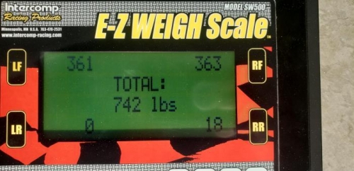

Took measurements for W&B prep
10/10 5
Misc from past couple days
Found fault in carburetor, need new one
10/11 3
Re adjusted starter
Ran wiring for speed brake indicator
Worked on aileron final balance
Aileron rigging
Found fuel leak on right wing tank vent
Need to reinforce speedbrake mount
10/12 3
Worked on aileron geometry
10/13 1
Drilled right and left aileron brackets and installed nut plate for control rod
10/17 3
Worked left aieleron control rod clearance
Transferred parts to new carb bowl
Worked on right fuel tank leak
10/18 4
Finished new carb install
Finished aileron linkage clearance
Engine run testing
Taxi testing
Wired new Ammeter shunt
10/19 1.5
Removed oil/fuel pressure sensors
Started working speedbrake reinforcement
10/20 1.5
Finished cutting wood for speedbrake
Wiring cleanup
10/21 1.5
Glued in speedbrake supports
Misc cleanup
Shop cleanup
10/22 3
Varnished speedbrake support
Found fuel leak in left tank vent
Sealed leak
Wired new oil and fuel sender
Fixed Ammeter
Made new aileron pushrods
Installed aileron gap seal
Tightened elevator cables
10/23 1
Added clamps to fuel lines
