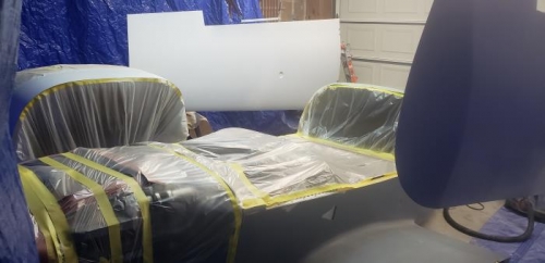

Paint prep
6/22 2
More garage prep
6/23 2

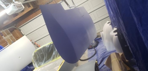

Sealer coat of epoxy primer on wings, canopy and cowling
6/24 3
Failed attempt at basecoat. Only canopy was completed
6/25 1
Started sanding off basecoat
6/26 1
Sanding
6/27 4
Sanded left wing to 600 grit, ready for paint again
6/28 4

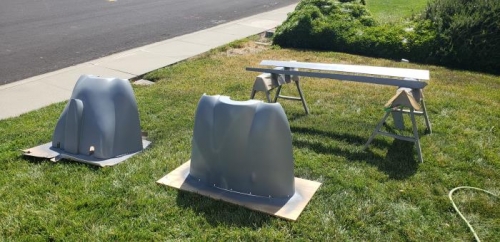

Sanded cowlings down
Primed top cowling again
Primed lower cowling intake
6/29 2
Blocked cowlings to 600 grit
