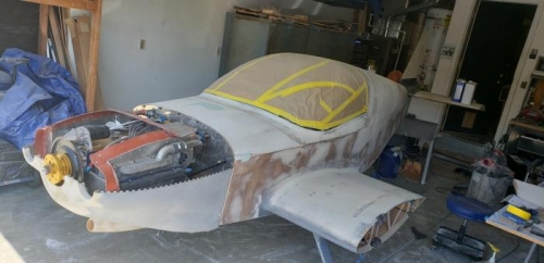

5/3 3
Sanded canopy/aft deck fill to contour
Sanded tail cover fill
Spot filled both
Fiberglass repair on canopy
Sanded cowling fill
5/4 3
Final spot fills
Applied two coats of smooth prime
5/5 2
Finished third coat of smooth prime
Commenced sanding it off

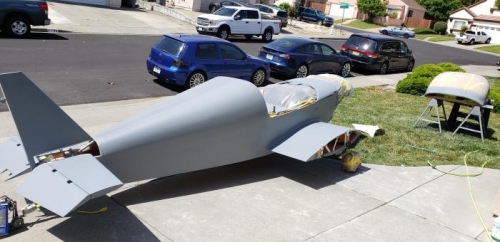

5/16 3
Prepped and sprayed 3 coats of 2K primer to fuselage
5/17 3
Blocking w/320
5/18 4
More sanding

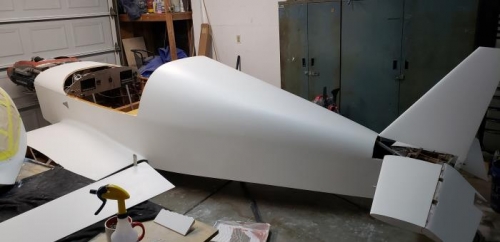

5/19 5
Finished fuse with 320
75% complete with 400
Wire cleanup
Wired control stick
Wired USB charger
5/20 3
Started 600 grit
Last coat of varnish in spots
More wiring cleanup
Ran wire to speedbrake actuator
5/21 2
Finished fuse with 600
