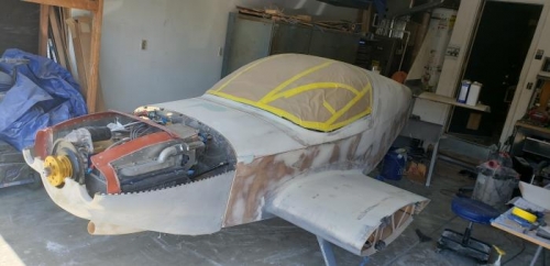

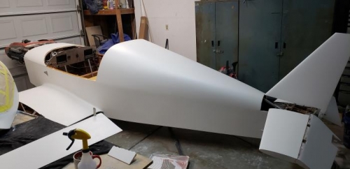

Brief Description:  More fuselage bodywork
5/1 1.5
Taped tail area as mold release
Glassed tail cover
5/2 4
Pulled tail cover from mold
Removed all pour foam
Trimmed tail fairing
Drilled/installed screws to fairing
Filled canopy/aft deck line
Filled tail cover
Glassed stub wing trailing edge sides
5/3 3
Sanded canopy/aft deck fill to contour
Sanded tail cover fill
Spot filled both
Fiberglass repair on canopy
Sanded cowling fill
5/4 3
Final spot fills
Applied two coats of smooth prime
5/5 2
Finished third coat of smooth prime
Commenced sanding it off
5/6 1
Sanding w/180 grit
5/7 2
Sanding
5/8 3
Finished blocking fuselage w/180
Glassed aileron end
Bent control sticks forward 30 degrees
Messed with stick grip wiring
5/9 5
-Mounted control sticks/routed wiring
-Sprayed 3 coats smooth prime to remaining parts
-Sprayed more smooth prime on fuse
-Started blocking fuse with 220 grit
5/10 1
More sanding
5/11 4
Finished sanding with 220
Spot filled defects with glazing putty
Started sanding down putty
