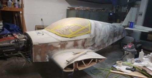

4/5 4 Mounted rudder pedals Sanded LL elevator to 80 grit 4/6 2 Elevator hinge gap work 4/7 2 Bolted in elevator Rolled on 3 layers of smooth prime Sanded it down 4/8 4 Wet sanding prep -Flipped airplane upright -Installed misc instruments and controls 4/9 4 Rigged elevator controls Installed seat belt Fitting work for canopy/aft deck Microed top of elevator 4/10 2.5 Glassed inside of aft deck 4/11 2 -Installed wings and worked aileron alignment -fiberglass work on ailerons 4/12 2 Glassed aft deck ends Started blocking top elevator Glassed left aileron repair 4/13 2 Trimmed glass from yesterday Microed 50% of ailerons Blocked elevator more w/80 4/14 1.5 Microed other side of ailerons Blocked elevator and filled lows 4/15 2 Glassed aft deck edges 4/16 2 Floxed aft deck to fuse 4/17 1 Glassed aft deck to fuse Cowling work 4/18 5 Microed front deck Sanded rudder Started sanding ailerons 4/19 5 Sanded ailerons and spot filled Sanded to 80 grit Worked on aileron control horns Sanded front deck and spot filled Sanded to 80 grit 4/20 2 Microed aft deck Sanded cowling 4/21 1 -Applied more micro on aft deck in spots -Glass repair on canopy frame -And of course, sanding 4/22 3 Blocking aft deck 4/23 2 Cowling work Canopy filling 4/24 2 Sanding Painted inside of canopy 4/25 5 Sanding Installed engine Wiring Cowling mods 4/26 5 Spot filled aft deck and canopy frame Cowling work Wiring work 4/27 2.5 Sanded aft deck spot fill Glassed wing root fairing Body work on cowling 4/28 2.5 Trimmed glasswork Microed front deck gaps and misc Spot filling Sanded down spot fills 4/29 2 Spot filling and sanding pinholes/lows 4/30 2.5 Taped off and filled tail area w/foam Sanded foam to contour for fairing
