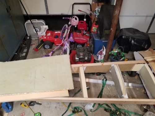

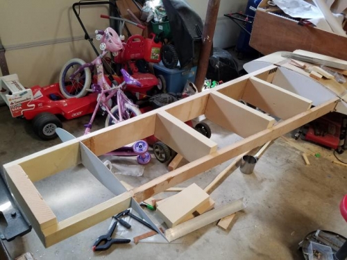

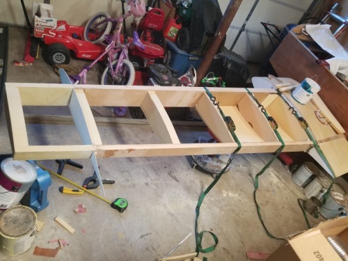

Brief Description:  left wing tank
4/23 1 made temporary template for root of outboard wing
4/24 1.5
-glued/sanded spar extensions
-Temporarily glued root template -Cut foam for in-board tank wall
4/25 1.5 cut foam panels for wing ribs and shaped in-board tank panel
4/26 1 glassed spars with two layers in wing tank area
4/27 1 glassed spar extensions and trimmed fuel sending unit to fit
4/28 1 glued tip template and foam ribs
4/29 1 Sanded ribs to airfoil contour
4/30 1 cut ribs 3/4" below contour and cut upper wing foam panels
5/1 3
- cut lower wing tank panel
- cut fiberglass for tank areas
- glassed upper tank panel and temp installed
5/2 1.2 glassed rib sides and added a layer of deck cloth to top panel to catch any pinholes from first layup
top panel and ribs glassed
