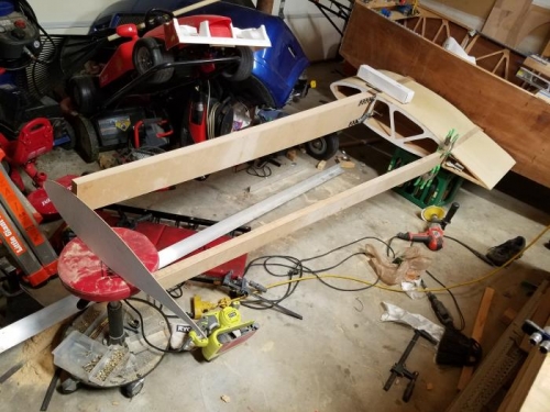

4/14 1 clamped wafs and started calculating wing tank volume. Also marked spars for taper cut

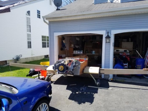

4/15 1 set left spar dihedral and drilled/bolted wafs
4/16 2 cleaned shop. Cut aft deck loose and removed canopy/forward deck for wing prep
4/17 1 drilled exhaust for egt probes and mounted pilot side headphone jacks

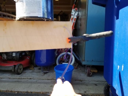

4/18 3 pulled plane out of garage, set right spar dihedral using water level and drilled wafs
4/20 .5 clamped rear spar to set washout
4/21 2 Tapered front spar with belt sander
