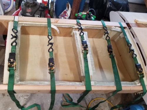

5/3 3 temp installed top with duct tape as a release and glassed two layers of 2" tape on all edges
5/4 1 more fuel tank glassing
5/5 1.5 glassed last top portion and center rib cutouts. Bottom ready for permanent install
5/7 3 glassed bottom and all corners

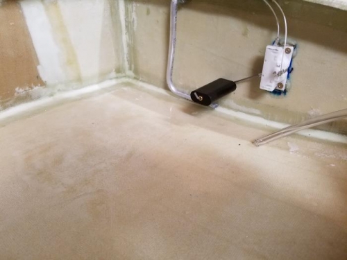

- cut hole for fuel pickup and started making line
5/9 2
-finished fuel pickup and bracket
-soldered new wires to fuel sender
-floxed fuel line and sender into tank

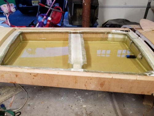

5/11 2
-filled tank with gas to leak check
- fuel sending unit not working right, tried to unstick
5/12 2
-made longer fuel float arm to fix problem and reattached unit
- fixed one minor leak and leak checked again
- floxed top of fuel tank on
5/13 1.5
- fixed three leaks found on top
- leak checked again, found another leak....repaired.
