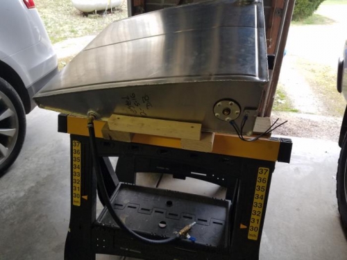

Fuel tank leak test
Filled tank with with 10 gallons of fuel. Left set for 24+ hours. No leaks detected.
Took 4.2 minutes to drain 5 gallons:
60 / 4.2 = 14.28
14.28 x 5 = 71.4 gallons/hour.
