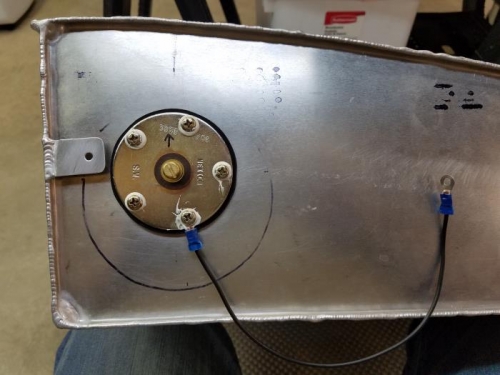

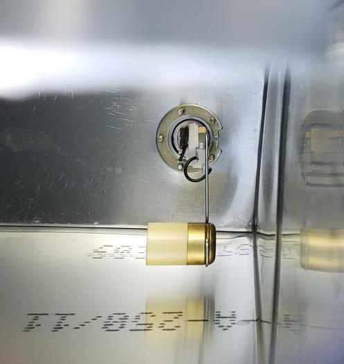

Installed fuel sender

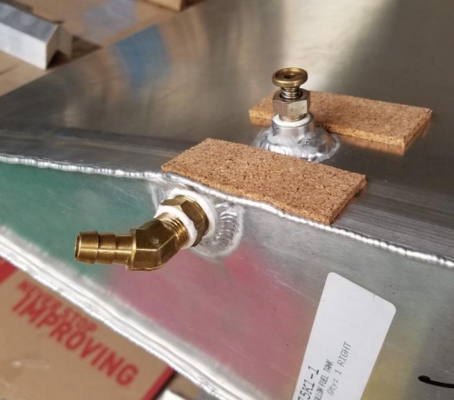

Installed fuel sender. Verified float range of motion and correct sender output: 30 - 240 ohms. Installed the fuel drain and feed port fittings in preparation for leaking testing.
