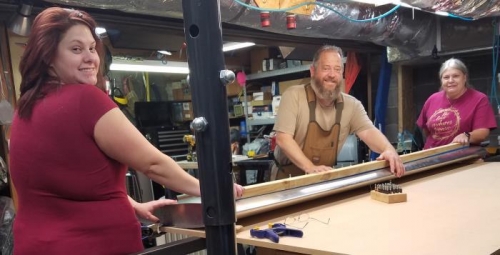

Brief Description:  Trued up HS and cleco'd top skin
Had some help from Pam and Jennifer to fold the skin over the top of the stabilizer. I had to do this several times because the it was putting a twist into the stablizer. I was trying to make all the holes line up, but that was causing the twist. I changed my approach and only cleco'd the holes that lined up without forcing. Most of the holes lined up just fine. I drilled the holes that didn't line up and all is good.
Take away: Don't force holes to line up.
I also shortened the new hinge extensions so that I will be able to get the three hing pins out after the elevator is installed.
