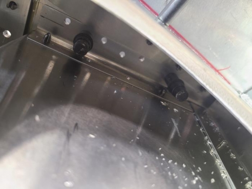

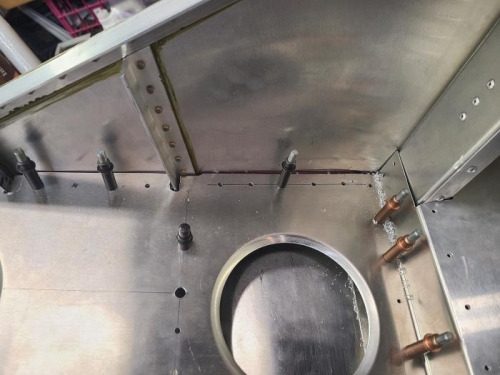

Brief Description:  Drilled gear channel L and seat base side support
Passenger Side
I missed the fact that there would be an L bracket between the gear channel and the gear strut fitting. I had already drilled the row of holes through the gear fitting at a height that was easier to drill. When I went to fit & drill this L bracket I realized my mistake and had to drill a few more holes to ensure the L bracket could be securely fastened. Leason learned. The other side should go much easier & faster.
I also fitted and drilled the side support seat base bracket.
