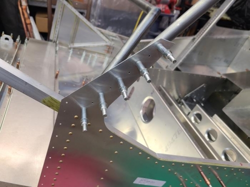

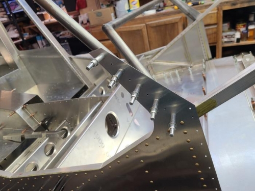

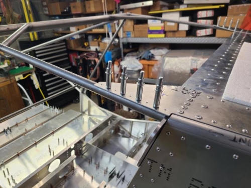

Brief Description:  Fitted and pilot drilled cabin frame
Cabin frame came from the factory cut to size. Yay! The only thing I had to do was file down the forward upright tubes a little bit so that the pre-drilled pilot holes matched up. This took a lot of time because I would file some off then re-install to see how things were lining up. This was repeated many times until the holes lined up.
