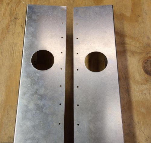

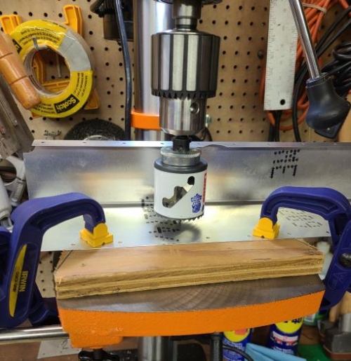

Brief Description:  Drilled 2" holes in the Flaperon Control Covers
Used a 2" hole saw in the drill press to drill a hole in each of the flaperon control covers so I can get to the back side of the upper end of the verticle control rods. I will cover holes with hole plugs after the flaperons are installed and adjusted.
