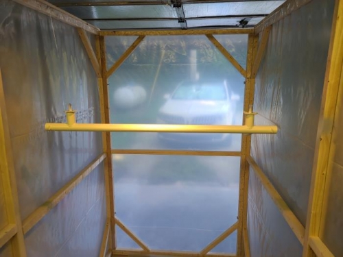

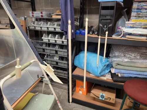

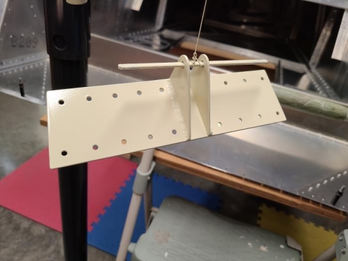

Brief Description:  Prep & paint flaperon control parts
Used Scotch Brite pads and Prep-All Wax and Grease Rmove to prep the steel control parts.
Sprayed parts with Rust-Oleum Professional Primer, then sprayed them with Rust-Oleum Professional Enamel. They look OK and should keep them from rusting for a good long while.
