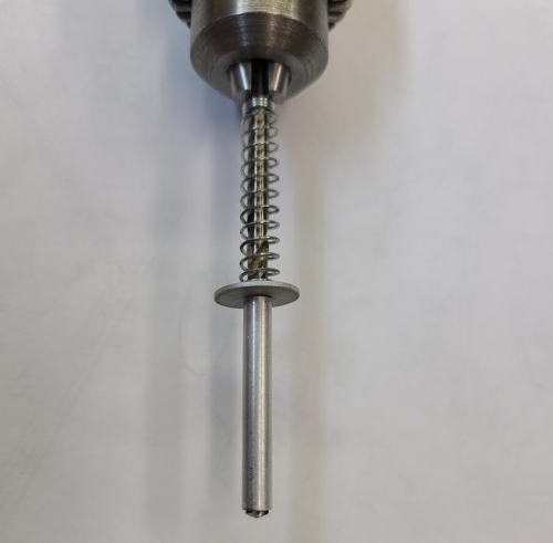

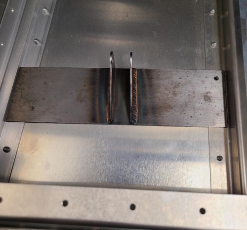

Brief Description:  Began drilling flap motor bracket
Began drilling the flap motor mounting bracket to match the pre-drilled holes in the fuselage bottom. Kudos to Randy and Gerald Resh for the idea to use the special drill bit setup shown in the photo. It allowed me to center drill through the existing holes that were already drilled to final size of #20.
