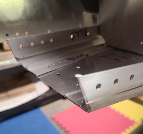

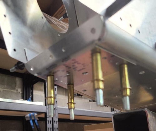

Worked on the backend of the rear fuselage
Trimmed the rear end of the bottom longerons.
Drilled the 3/16" holes in the bottom fin attachment bracket and longerons.
Deburred the fin attachment brackets.
