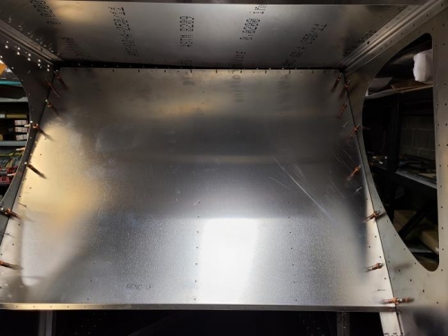

Brief Description:  Prepared baggage back panel for drilling
Deburred baggage back panel and brackets. Cleco'd back panel in place and cleco'd top skin on fuselage so that I can drill the top the top bracket on the back panel. Discovered that one of the support L brackets on the top skin intereferred with the back panel top bracket. Will have to address this before I can drill the back panel bracket.
