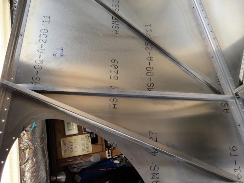

Randy's 750 Cruzer Project
Date:  3-25-2020
Manual Reference:  C75-FA-1

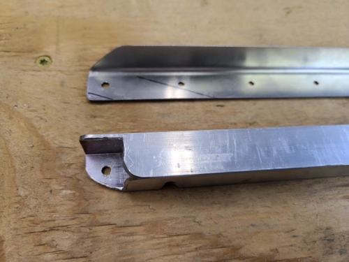

Brief Description:  Cut & shaped fuel header tank support tube
Since the new support tube is a tube instead of an L brachet, it caused interference with the baggage back channel C75F6-7. I cut and shaped the tube so that it would not interfer.
I cleco'd the finished tube in place. I will not rivet it until I get the fuel header tank and determine where the mounting straps will go through the tube.
