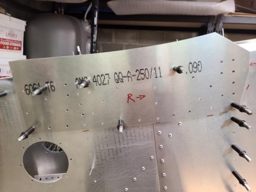

Date:  3-14-2020
Number of Hours:  3.00
Manual Reference:  C75-ZA-1
Brief Description:  Drill H.T. attachment bracket & fuselage skin (R)
There were extra and missing holes in the horizontal tail attachment brackets and side fuselage skins. I cleco'd right side bracket in place using existing matching holes and drilled the holes that were missing. Took my time to ensure everything would line up good.
