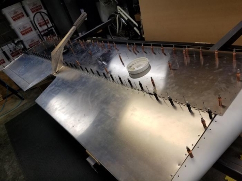

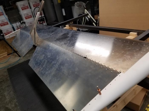

Brief Description:  Riveted skin and elevator into place
Cleco'd elevator into place and checked to ensure the stabilizer was still trued up. Next I riveted the skin except for the rear spar/hinge line. Last'y I riveted the hinge line, securing the elevator into place. Checked operation of the elevator. It moves smoothly with no binding or twisting!
One end on each of the pins for the hinge extensions was bent to make it easier to remove. I got this idea from the Zenith builders forum.
The stabilizer is ready to be wrapped in plastic and stored.
