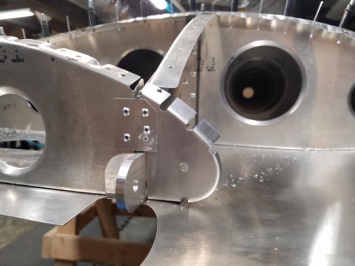

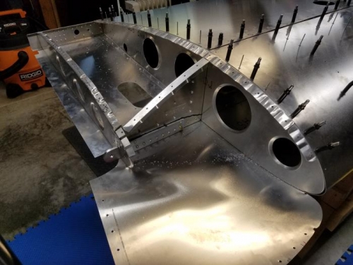

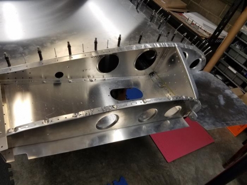

Started drilling wing root top skins
Install root angle strip. Installed joiner piece on root rib. Crimped skin joiner strips to fit curve of the rib. Clecoed top root skins in place and drilled to final size.
