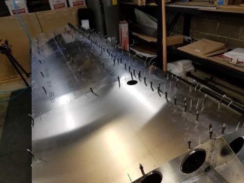

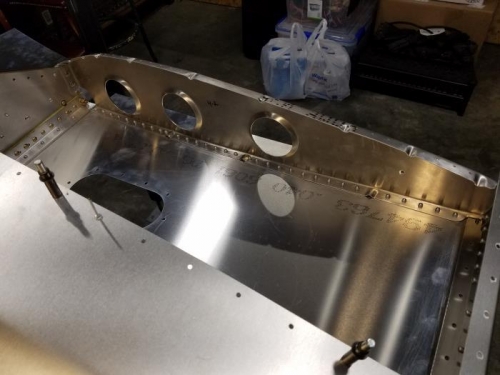

Drilled spar line to final size and installed root
Drilled spar line to #20. Clecoed and drilled root rib. Deburred and riveted root rib into place.
