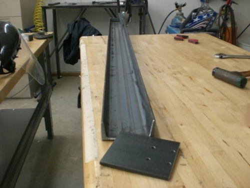

So after getting about $30 of steel and casters from HF Aircraft Supply I set about measuring and designing the dolly. I cut and drilled the landing gear axle hole locations on the end plates and the channel iron to correct length.

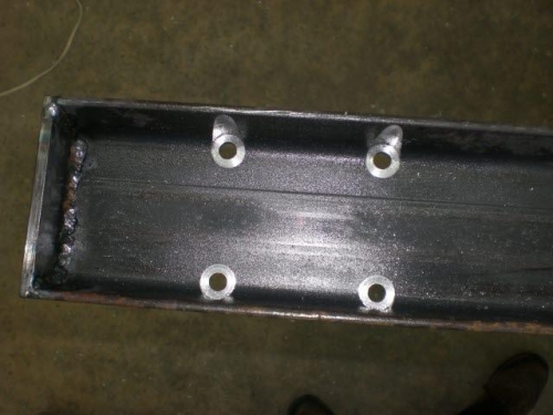

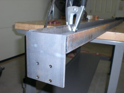

Next I began by welding the plates on the ends of the channel iron. I completed all that in the first work session.....pic 3 is actually from tomorrows session but I wanted to utilize the picture frame in today's post. The castors required I cleared the radius in the corners of the hole locations with an endmill to have a flat surface for the bolts.
One end welded
One end welded
Channel and bar stock
Holes drilled for castors
