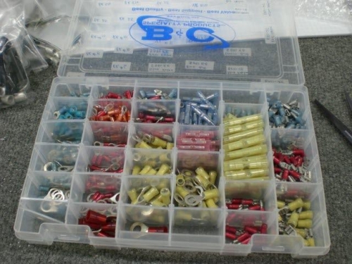

So the shop needed a good cleaning up and straightening out which I took a while to do. I also had some electrical hardware from B & C and miscellaneous hardware from Aircraft Spruce to get sorted and put up....so I did that too.

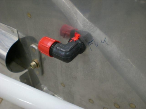

Lastly I replaced the aluminum AN fitting for the fuel supply that passes through the firewall from the fuel pump with a steel fitting I purchased. Hopefully I will never have to deal with a fire in the engine area....but if there is one the steel fitting will resist melting far longer than then aluminum one!
Sort electrical terminals and hardware
Replace alum AN fitting with steel AN fitting
