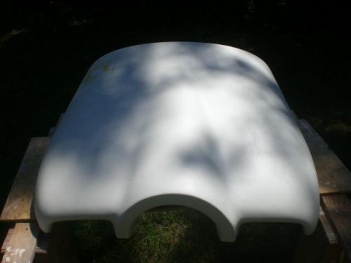

Though it was still going to be hot....the forecast was to be about 10 degrees cooler and a mild cold front that passed yesterday took away quite a bit of humidity. I decided to get back on the top cowl and try to get more Smooth Prime on it to keep the progress going so I wouldn't be working on all the fiberglass at the end since it takes time to cure.
I took the last of the can #1 I had and laid coat 4 of the primer to the cowl. The good thing about Smooth Prime is that it is water based. Putting a coat of primer on the cowl only takes about 20 minutes or so and cleans up with water....so far I really like the results.

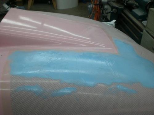

The only problem with the Vans "Pepto Bismal" pink cowlings are the honeycomb mesh that causes divots to form (see build log 6-19-2023 for further explanation). I called the folks at Poly Fiber who make the Super Fil epoxy filler and asked them if there was a way to thin the product with acetone or other chemical because the consistancy is on the thicker side. The tech suggested just taking a heat gun and applying a little heat to thin the epoxy mixture being careful not t overheat. Using a piece of aluminum as a pallet I mixed some Super Fil and using the heat gun heated up the filler I watched it as it appeared to thin. I took the spreader and sure enough it really spread easier and thinner. I had to reheat a few times untill the batch was all spread...I think this will work well....we will see tomorrow.
