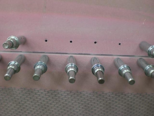

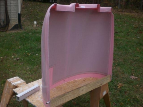

I was able to get out in the shop and get to the cowlings in order to sand the edges outside to get the 1/16 inch gap between the edges established. So taking the top cowl outside while it was still light I used the permagrit sanding blocks and the 3' long homemade sanding angle to get the gap established using the lines I drew the night before.
By the end of the session the top cowl has the gaps completely done and the bottom cowl just needs the firewall edge completed.
Best to do it outdoors!
