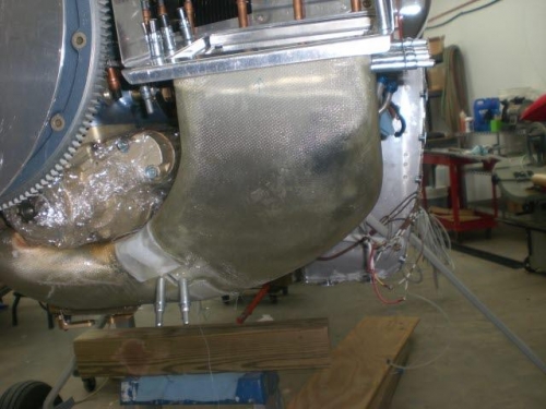

Snorkle glassed with first round

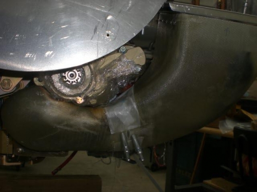

Waiting to cure
Waiting to cure
