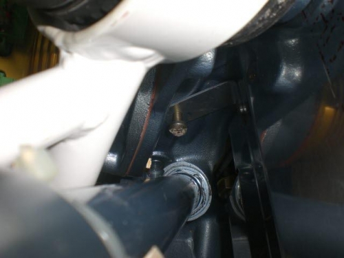

Brief Description:  Baffles general cleanup and fitting
I spent the time just finding places on the baffle that had to be filed or cut a little more in order to get some clearance from the engine and other parts. I struggled with a screw that holds the #3 baffling. It is right by the oil dipstick tube and it is next to impossible to get in there to put it in let alone get it tightened.
I was finally able to do so just enough to hold the bracket in place in order to make sure the baffle does not move while getting it cut to size. I will either remove the oil tube for final installation or make up a tool to get in the area to tighten the screw.....lots of time spent on it!!!
Last work session saw me hit 3300.1 hour mark......still plugging away at the speed of snail!!!
Screw is a pain!
