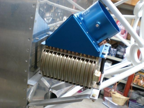

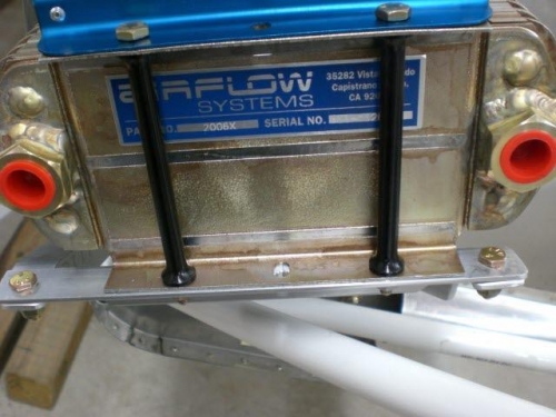

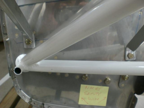

I drilled the location for the top mount support bracket bolts after getting the supports right where they needed to be set. I had left extra material on the brackets in order to get the fit correct and then have the extra material to trim and match the supports with the front oil cooler mounted angle.
So after getting the supports located and drilled I marked the excess that needed to be trimmed from the support arms on the top, removed them and cut them on the band saw.
That's all for tonight....will do a little more finishing on the supports tomorrow.
Bottom support attachments
Top support attachments
Side view of oil cooler mount
