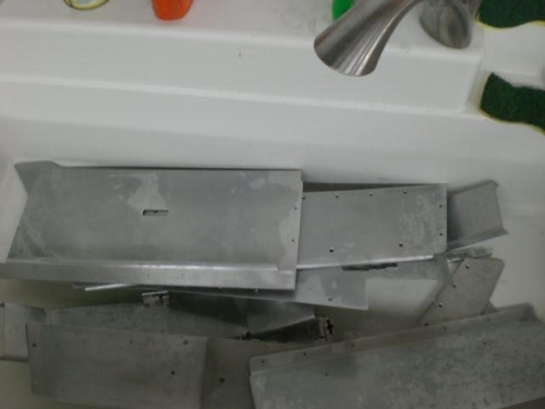

I decided it was time to prime and paint a collection of parts that needed to be done and keep the project moving.

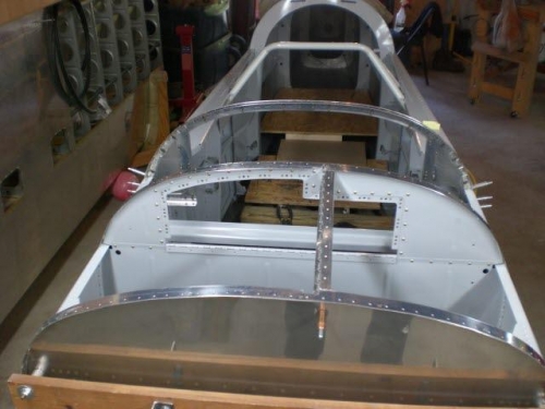

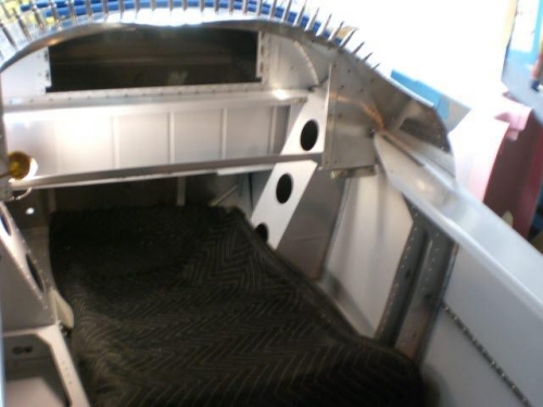

I removed all the console parts and spar cap covers. I also took the top skin off the airplane. I began the monotonas task of sanding and prepping the parts for priming and painting.
I have been using Stewart Systems products. I am really satisfied with the products. The ones I use are the Eco-clean that gets parts squeeky clean, the Eco-etch that etches the parts prior to priming, and the Eco-primer and Eco-poly for the topcoat. I really like that it is water based and with the hardness of the finish I am sold on the product.

Spar caps and consoles removed
Top skin removed
Top skin removed
Cleaning parts
Cleaning parts
