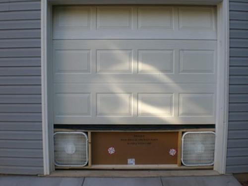

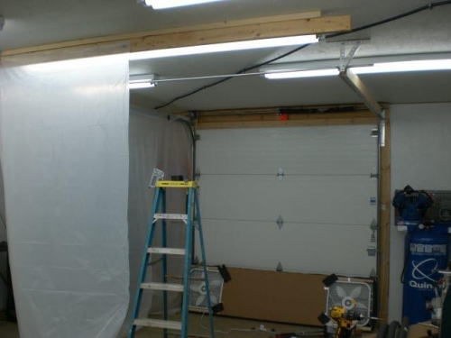

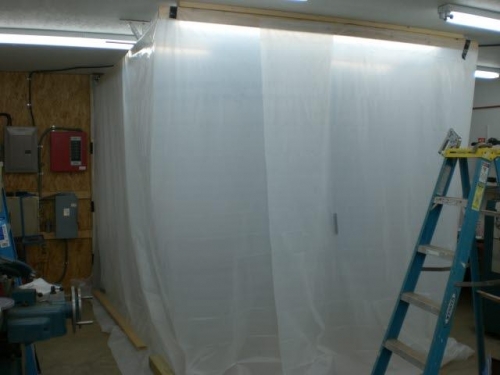

The weather has turned from pleasent low-humidity to hot and humid. I went and bought some plastic rolls along with a couple cheap fans from Wally World.
I felt that in the climate controlled shop I could paint without the issue of heat and humidity. It really worked well and was pretty cheap and easy to build.
