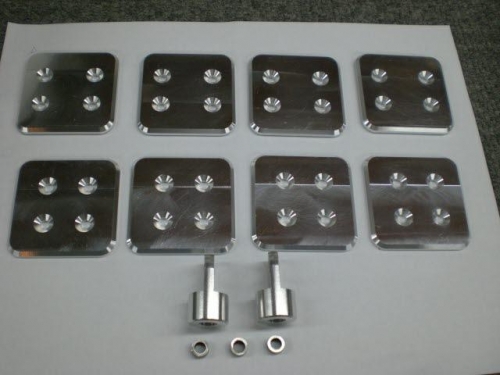

I took time on Sunday and Monday to finish the RV-10 covers....and shipped them to Rick on Tuesday.
In a way is was a nice diversion from the project as I love machining now and then. Photo 3 shows the parts made or modified.

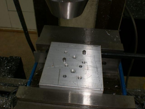

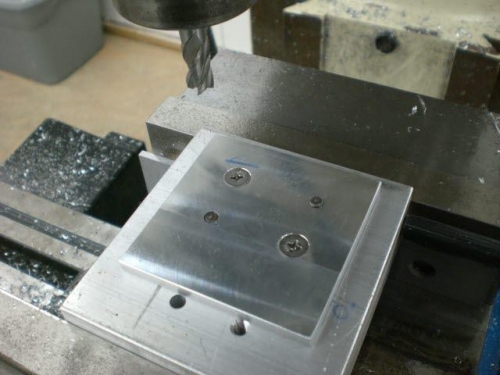

The RV-10 cabin and door covers have different hole pattern locations. So I made a fixture that would use two dowel pins to locate the parts and two screw holes to hold it down while machining. I was able to cut the cabin covers then shifted down to the second location on the fixture and cut the door covers. The door covers had a caveat to them in that the holes were shifted .040 for hinge slop to be shifted to one side. Rick is a real detailer in this manner. So I wrote a program and ran the parts. Unfortunately it is time intensive by the time all the processes are run, programs written, and parts completed. The cabin cover also required a .025 boss to be milled in the back in order to fill a gap between the hinge and the cabin surface.
In addition I modified the rod ends for the door struts and made spacers to fit in the rod end holes.
Project complete.....back to the build!
Dual fixture for both covers
On fixture ready for cutting
Finished parts
Finished parts
