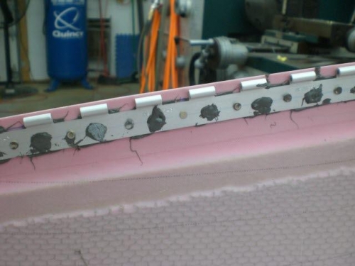

He showed up in the afternoon and since the riveting and bonding of the cowl hinges was a priority on my list we tackled that job. I had just started countersinking the rivet holes when Rob poppe into the shop. He said he would take over that portion while I mixed the pro-seal.

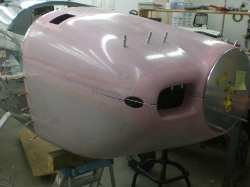

I laid the pro-seal onto the hinge lines that I had taped off to keep the pro-seal where it needs to be and not on other areas. After I finished laying pro-seal on the first hinge line we clecoed the first upper hinge on and Rob got to riveting while I continued laying pro-seal on the rest of the hinge areas.
It took a little while to get all the hinges on and set but we did and Rob helped me put the cowling on to let the pro-seal set a bit. I will remove the top cowl later tonight to bond the cowl inlet ramps.

Pro-seal
Pro-seal "rivets"
Look Ma.....no cleco's
