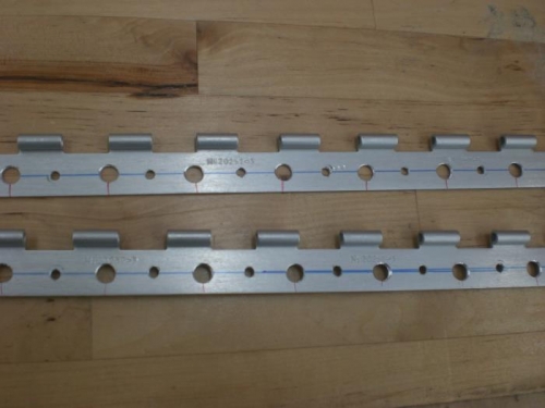

Back in the shop tonight I took the hinge halves I removed from the top cowl and began to mark out holes to cut for allowing the Pro-seal to form liquid rivets on the hinges to assist in holding the hinges in place with all the wind and vibration in the cowling area. I actually purchased soft rivets to attach the hinges....but Vans recommends using epoxy or pro-seal to additionally help in bonding the hinges and adding strength.

Modified Top Cowl Hinges
