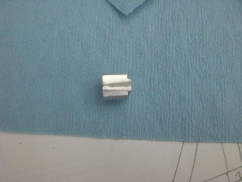

I finished making the buttons for the TCW mount that I am using to capture the mounting flange.

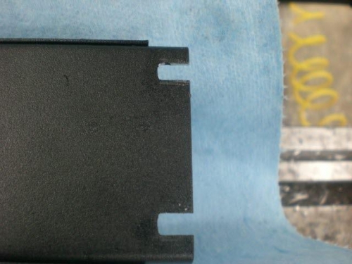

Next I set the battery up in the vise and milled out the attachments holes to slots that I am going to use to slide under the buttons I made in order to capture the attachment flange under the buttons. I don't want to try to take out screws or nuts to remove the TCW. The mounting surface towards the front of the airplane will slide under the buttons and be captured and then the two screws at the other mount towards the rear of the panel area will lock the TCW in place.

Buttons Completed
Buttons Completed
Slots milled
Slots milled
