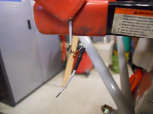

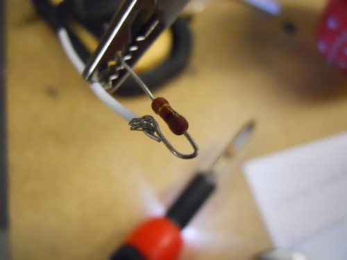

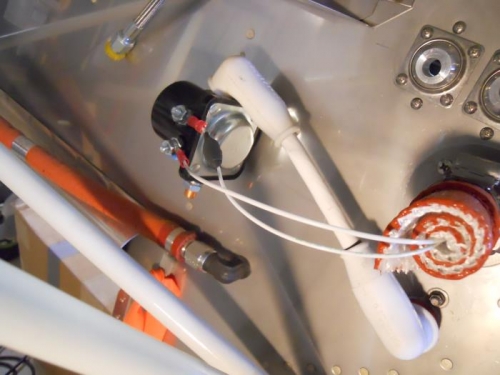

Brief Description:  Starter contactor wiring
Finished up the two wires that run to the starter contactor. The wire that connects to the ā€œiā€ terminal to report to the EFIS requires a 1k ohm resister to be placed inline near the contactor. I soldered the resister to the wires and covered with shrink tubing. Crimped on the terminals and attached the wires to the contactor.
Soldering wire to resistor
Soldering other end of resistor
Wiring to starter contactor
