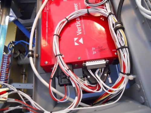

Date:  3-16-2015
Number of Hours:  1.00
Brief Description:  Starter contactot wiring
Today I ran a couple of wires that will terminate at the starter contactor. One wire runs from the start button to the “s” terminal on the contactor, and the other wire runs from the VP-X to the “i” terminal. The wire to the “I” terminal allows the VP-X to report to the EFIS when the starter is engaged. The starter annunciator wire from the VP-X is the last wire for the J2 connection, so I added the strain relief and shell to the connector and called it done (at least or until I find something else to plug into the J2). I spent some time securing wiring bundles with zip ties—but still have a few more to go. I would like to think I’m about done with wiring, but stuff just keeps creepin up.
Tied up some wires
Tied up some wires
